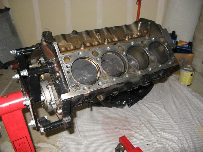

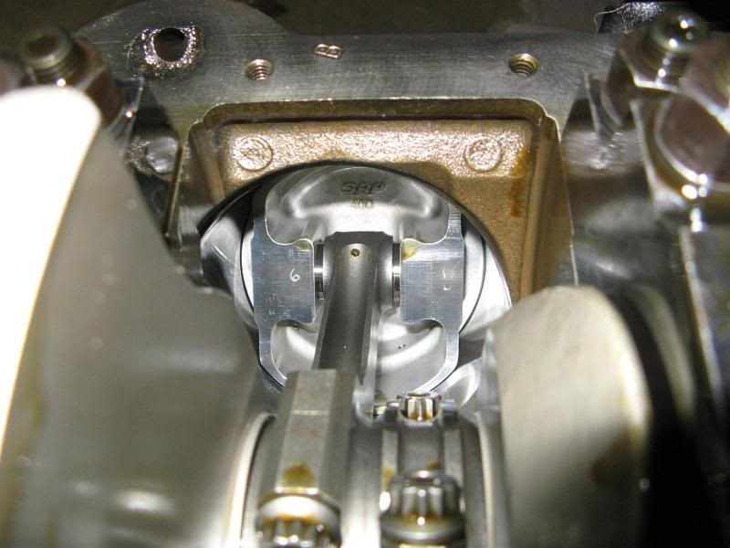

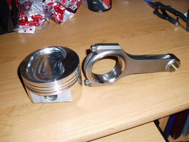

    Default My Turbo Build

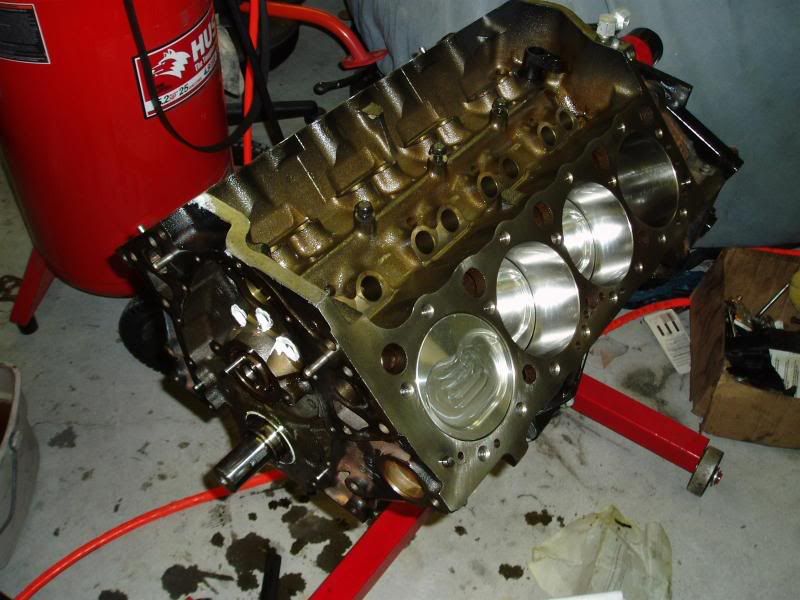

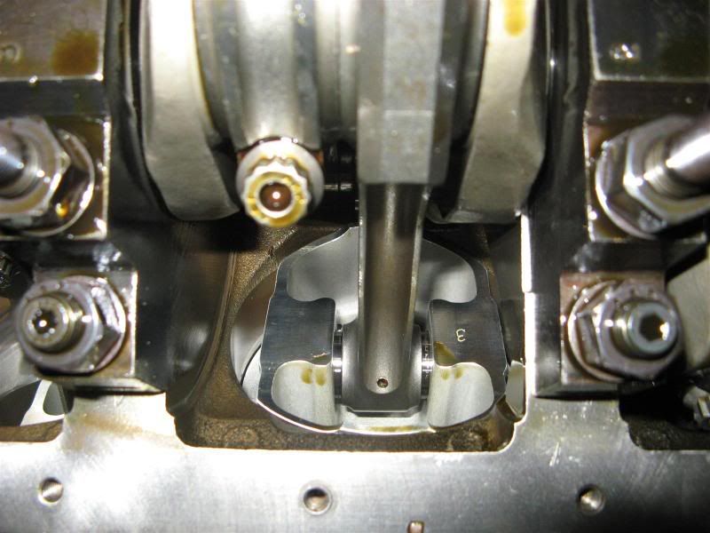

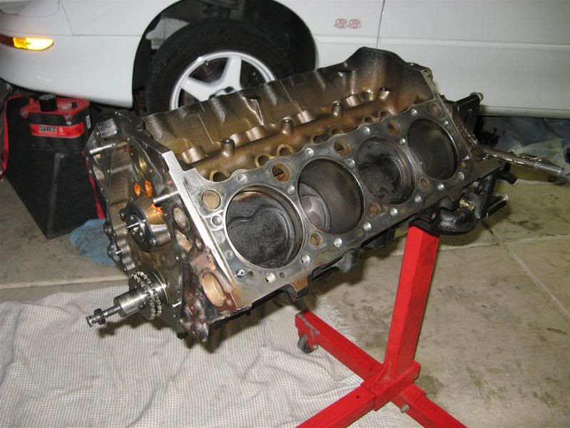

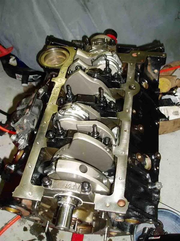

    Engine:
    Forged 355
    Eagle 4340 crank (3.48'')
    Eagle 4340 5.7'' rods
    billet 4 bolt mains
    SRP, forged pistons, 24cc dish
    JE piston rings
    Hot tanked
    align bore
    machine maincaps
    bore/hone .30 over
    neutral balance assembly
    bearings( fed mog mains, m77 rod, duraband cam)
    Canton oil pan
    Comp Custom Grind Turbo Cam
    Stock:
    Heads
    Intake
    Fuel:
    Racetronix/Siemens 63lb injectors
    Fastbird's Custom Fuel Rails
    Custom Double Pumper (dual 255s, -8AN feed, -6AN return)
    Aeromotive Adjustable Fuel Pressure Regulator
    Electronics/Spark:
    Stock Opti for a few months, then LS1 coils and Megasquirt II
    PCMforless initial tune then custom tune..
    NGK TR6s
    Stock PCM

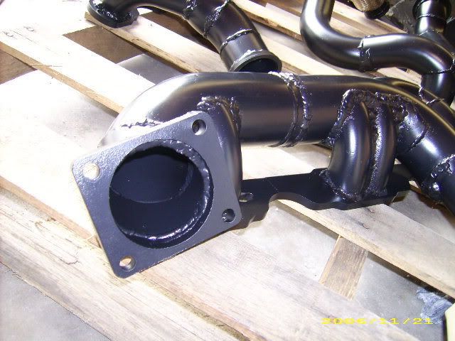

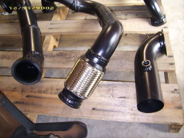

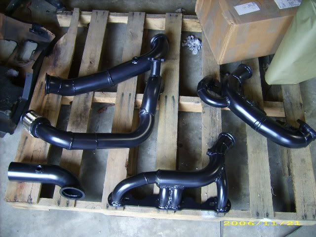

    Turbo:

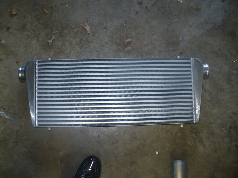

    e bay 12”x4”x36” air to air intercooler
    Tial 50MM BOV
    REALQUICK hot parts
    Custom Log Manifolds
    All mild steel (except the Vband clamps)
    Pass. side log - 1.75" primaries and 2.5" log
    Crossover: 2.5"
    Driver's side log - 1.75" primaries and 3" log
    Downpipe - 3"
    Tial 44mm Wastegate
    TC78 F1 Trim turbo
    Note:

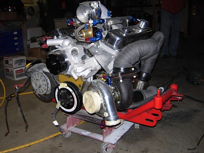

    The motor with the turbo kit mocked up is not mine, it is the guy's who I bought the kit off of on Camaroz28.com
    -Ryan
    93 Z28 M28
    Mod List

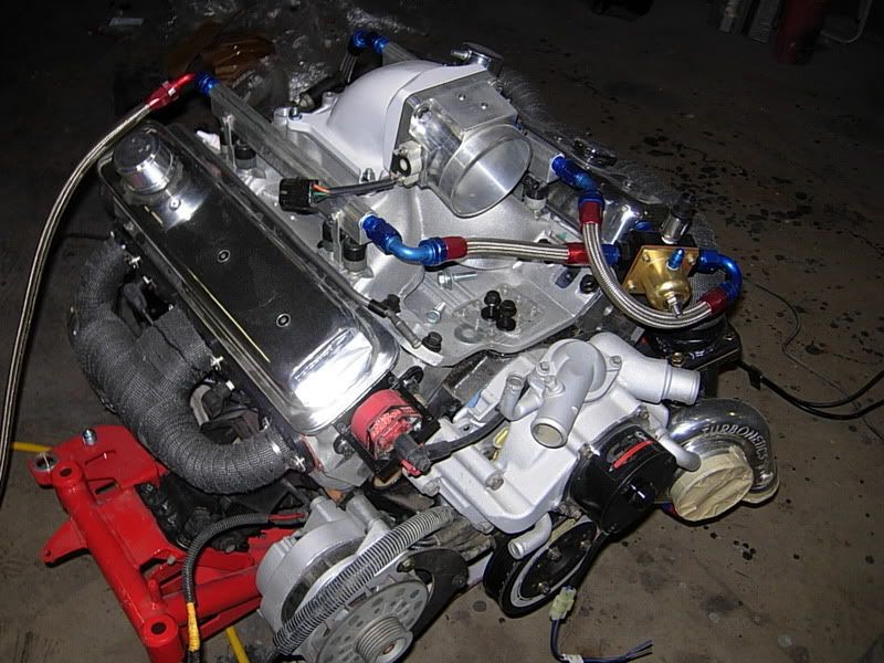

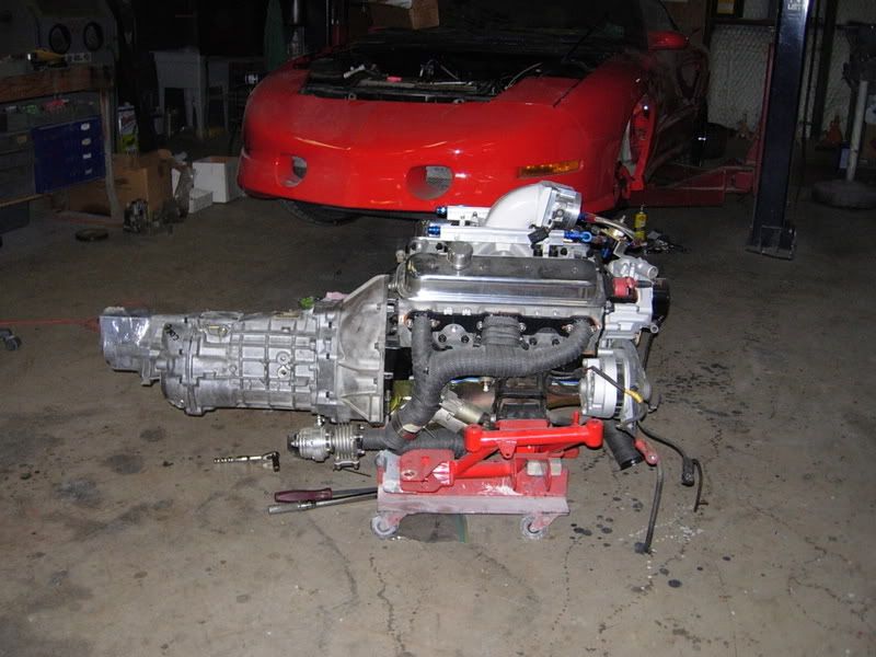

    nice... so let me get this straight is it single or twin turbo???? Cause I see one turbo on one side but I don't see the other one and the exhaust goes backwards......
    West Coasts Fastest OEM block 4th gen
    9.06@153.8 1.35 60', 10.62@127 all motor
    CSM Racing Engines 383, SR, single plane, etc!!!!!
    Pr0jekt Turb0?
    Online
    Ryan
    1993 Camaro Z28
    Utica, NY + Jacksonville, FL
    3,621
    It is single, there is a crossover pipe that can't be seen in the pictures that merges the passenger side with the driver's
    -Ryan
    93 Z28 M28
    Mod List

    That kit should make great power! My welds are 100% better now on my newer stuff (built that kit awhile ago). That same designed alreay made 574rwhp @ 11psi on a load bearing dyno by one of my other customers.

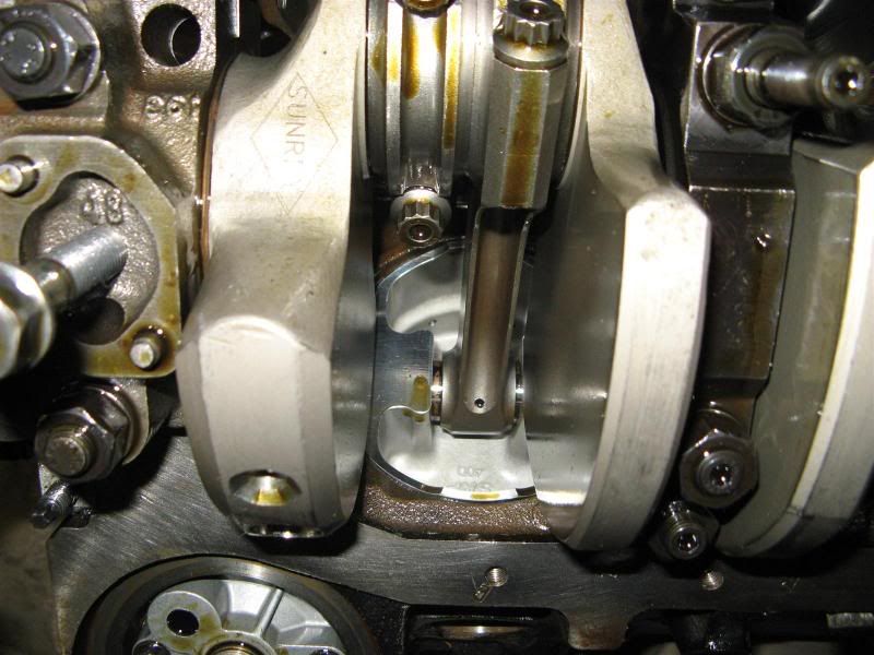

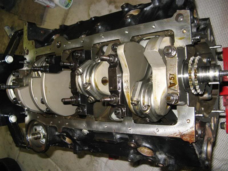

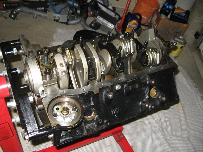

    Those are some really good progress pictures. Looks great!
